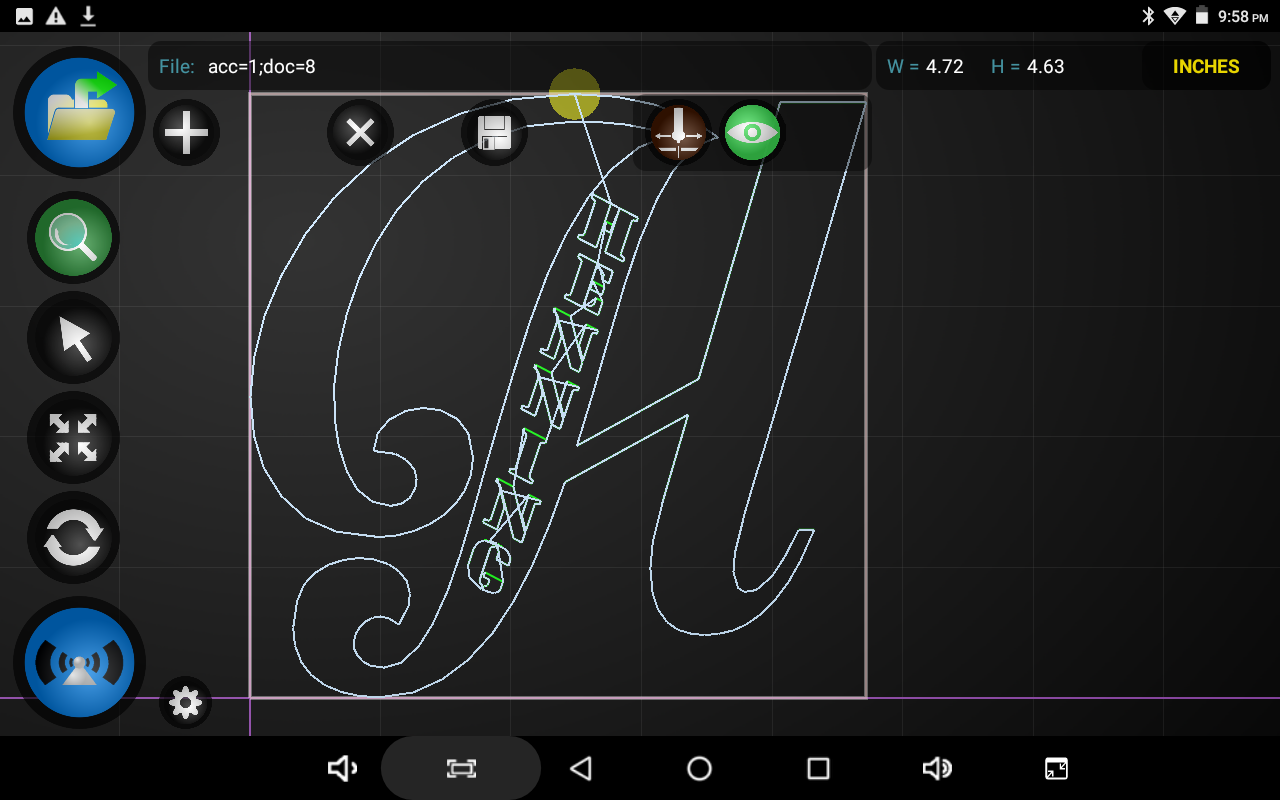

Hi Dave (or anyone that can help me), I saw your video and have been doing things a little differently. I tried to use the cut styles on the gofab app but something isn't right. I attached a picture of what I get when I use any of the cut style tools and this happens to every design I have. All I really need is to change the cut order so it cuts in the right order. Any pointers will be highly appreciated!!

Make sure you're using the latest tablet software. You can get the update here:
http://gofabcnc.com/updates/
If that doesn't fix it, send me the gcode file and I can figure out why it isn't working.

Here is the cut file. Sam walked me thru the update a couple months ago I should be up updated. Thank you so much for your help!

Ahh, I do see a tablet update from a couple weeks ago i must have missed. I will see if that will fix the problem.
